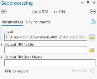

Hello, i have this problem
Arcgis PRO DOESN'T detect tin name in the geoprocessing tool LANDXML TO TIN

Looking at the LandXML to TIN geoprocessing tool, the input is the LandXML file, the Output TIN Folder is a folder you want the TIN to be created IN so you'll need to identify the folder rather than a file.  The Output TIN base name is the basename of the resulting TIN to be created.  You read more about it here.

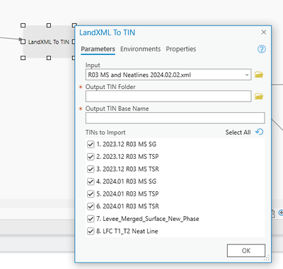

Anthony_Herman
The names show up in the tool, but do not seem to be used in folder creation/naming. The "base Name" is just set to the integer of whatever surface order exists. So how can I reliably match up (in model builder) the surface name and the resultant TIN name?
