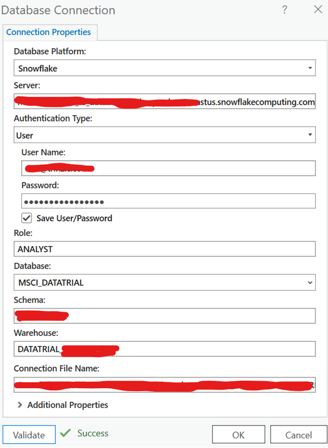

I have successfully validated a database connection to a snowflake server, and I can see the different databases available, so I believe the connection properties are correct, but when I try open the connection via Catalog, no tables are returned.
I followed the below guidance:
https://pro.arcgis.com/en/pro-app/latest/help/data/databases/connect-snowflake.htm
Currently using: ArcGIS Pro version 3.2.0, Snowflake ODBC client 3.1.4
I also have the connection working in ArcGIS Online, so the issue I have is with ArcGIS Pro specifically. Any ideas please?
