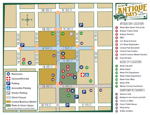

Best I've been able to do is make a normal legend with whatever labels you want (aside from the numbering), then copy and paste it. Select both & align left, align top so they're lined up. Then, make a copy of the actual layer and change the symbology (or just the labels) to your numbers. Go back to that copy of the legend and swap your original layer with the numbered one, and convert it to graphics. You could also skip that and just convert it to graphics right away and change it to numbers manually. Delete the duplicated patches and any headers/titles, shift the numbers left, and apply your label symbology. It's tedious, but looks fine.
I always make a copy of the legend before converting to graphics in case I need to start from there again.
