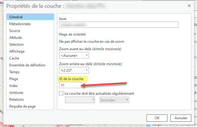

Hi!, I need to get the layer id within a map in ArcGIS Pro.  It need to be done with Python, but can't find the way to do it.  Any idea ? Impossible ?

FrancisMoisan1
Thanks for the info, but that "id" is just the order within the project.  I look to get the ID that is attached to the layer within the properties.
HannesZiegler
Ah I see, yes you can get that:
aprx = arcpy.mp.ArcGISProject("CURRENT")
m = aprx.listMaps()[0]
lyrs = m.listLayers()
for lyr in lyrs:
    print(lyr.getDefinition("V3").serviceLayerID)
Have a look at CIM access, it's quite useful, there is much more you can do with it besides this
FrancisMoisan1
That was it!  thanks!
