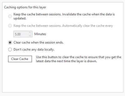

Hello,
I noticed that the cache functionality does not seem to improve performance when our data is from ArcGIS Online.  I panned around on my map and I did not see any performance benefit between caching and not caching data.
Is there a reason why caching does not seem to help when using AGOL data?  If it helps I should note that caching data from a network Geodatabase works fast and flawlessly.
Technical information:
  • ArcGIS Pro 3.1
  • Data from ArcGIS Online hosted feature layer.
  • Panned around on the map enough to populate the cache in my session
  • No speed improvement between not caching data.
  • AGOL is "healthy" according to arcgis.com
Thank you for your help!

Thank you for your reply.   I have not changed anything in the map, layer properties, definition query (none), or data (editing is disabled on the feature service).
I also added "Feature Cache" to my toolbar, verified autocache is enabled, so I would expect the cache to be filled as I pan around on the map.  Unfortunately I am still not seeing any performance benefit when I pan back on my map.
It sounds like i am doing everything right so I wonder if I should test the functionality on a different machine or call support..
