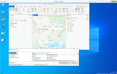

Apple M1 Running ArcGIS Pro and Desktop as follows
1. Apple iMac M1
https://www.apple.com/imac-24/
2. Parallels (Install parallels on M1 Computer)
https://kb.parallels.com/en/125038
3. Windows Insider preview ARM 64 (Install Windows
- https://www.microsoft.com/en-us/software-download/windowsinsiderpreviewARM64
4. Install ArcGIS Pro and/or Desktop on Windows VM
45 Replies
MarcelSt-Germain
Hi, Pro 2.8?  Have you make some tests?  Any issues?
SeanAdlai
Hi Marcel.
Yes
Pro - 2.8
Desktop - 10.8.1
No Issues so far.

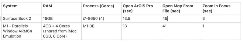

SeanAdlai
Hello Marcel.
Here are the tests I performed
Hope this helps
SeanAdlai
This might be clearer.
MarcelSt-Germain
Thanks,  it's like even with emulation and limited memories, it's very useful.  At least very more than my emulation of arc view with my iMac sunflower with virtual pc.
Can't even dream of performance if ESRI can compile ArcGIS Pro for arm and skip the emulation of x86 codes.
