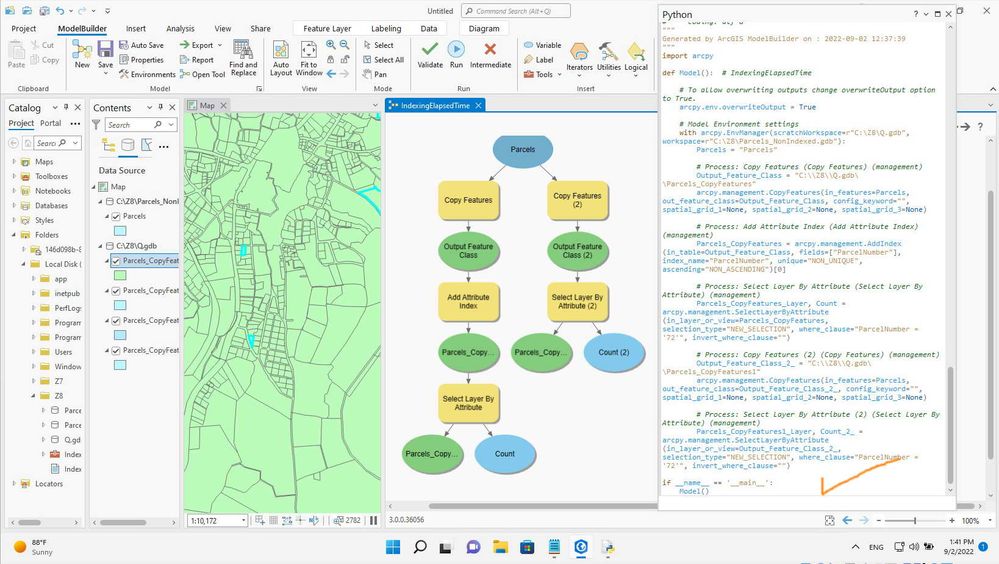

I exported the model into a python but couldn’t figure out how to stick the piece of code you have already provided in order to get the time printed.
Could you please help me on this?

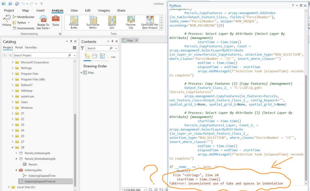

JakeSkinner
Esri Esteemed Contributor

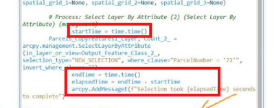

Make sure the indentation matches for the highlighted lines.  They should align with the same indentation as the Parcels_CopyFeatures1_Layer,.... line.

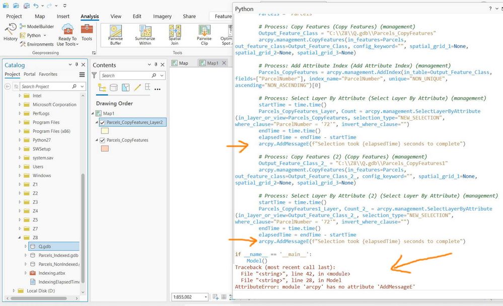

JakeSkinner
Type-o on my part.  Just remove the extra E in arcpy.AddMessageE (line 28 and 29).  Should be:
arcpy.AddMessage(f"Selection took {elapsedTime} seconds to complete")

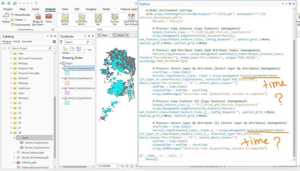

JamalNUMAN
Legendary Contributor
It works fine but the elapsed time is not printed for the “select by attribute” tool

JakeSkinner
How are you running the script?  You may need to change arcpy.AddMessage to print.
