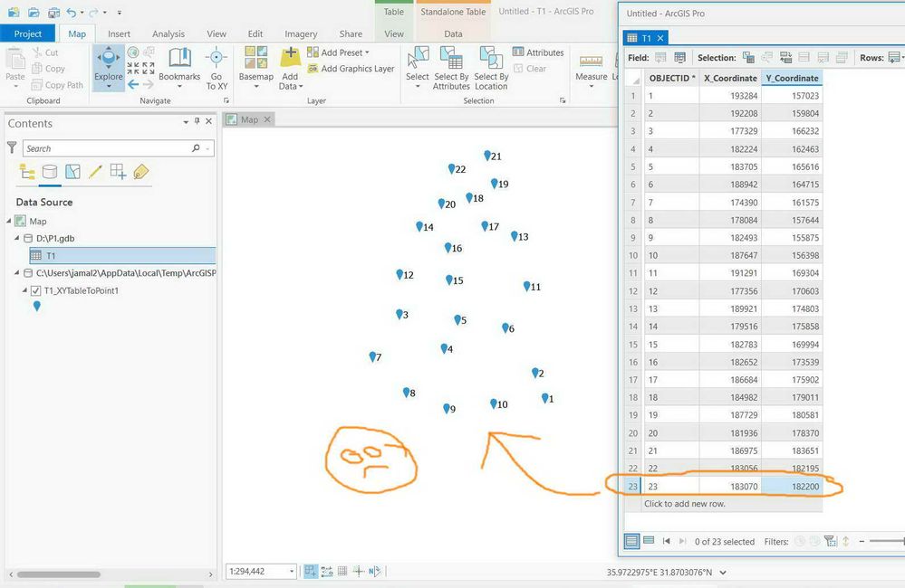

For example, in the screenshot below, 20 points are displayed.
Now, if a new record is added to the table with xy coordinates, how to get it plotted automatically?

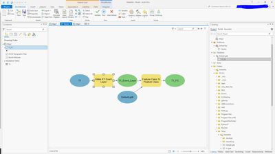

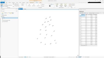

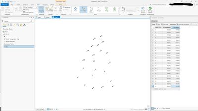

Jamal - dynamically I don't think you can do this but with a simple model you can.  I created a model using 2 GP tools - Make XY Event layer and Feature Class to Feature Class.  Below you will see my progression from start to finish.  This model can be run manually or automatically as a python script using Windows Task Scheduler to run every morning at 3 AM.  See my graphics below:

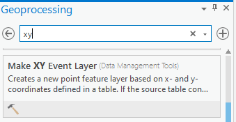

I realized that if you run the Make XY Event Layer gp tool then it adds the points tot the map and updates on the fly and not create a new layer but just displays the points. No need to schedule a script to run to update.
