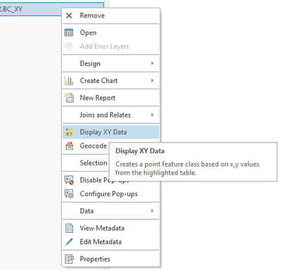

1. Right click layer in TOC --> "Display XY Data"
  • I find that wording to be misleading. The word "display" makes it sound like we're creating a dynamic event layer, which isn't the case. It creates a new feature class.
  • I know the info in the mouseover explains it a bit further. But I honestly don't usually think to hover/wait/read the mouseover text. Could the "Display XY Data" wording be improved?

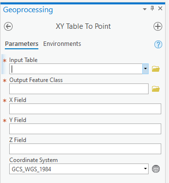

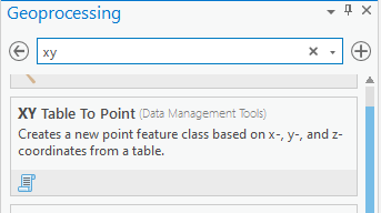

3. Ribbon --> Analysis --> Tools --> Search for "XY" --> "XY Table to Point" GP tool.
  • This tool is pretty straightforward. It creates a new feature class, which is clearly stated in the tool description. And is obvious because we need to fill in the "Output Feature Class" parameter.

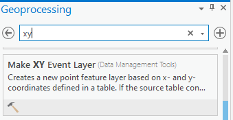

Note:
The three options above are not to be confused with the "Make XY Event Layer" GP tool, which creates a dynamic event layer, not a feature class.
