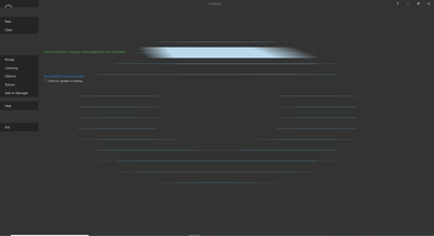

Hello Y'all.
I booted up my ArcGIS Pro tonight and saw bizarre UI glitches in my ArcGIS Pro panes.
I shut down my computer, and Started it up again only to find that this issue still persisted.
The wonky screenshots are below.
Has anyone encountered this?
Thanks!
-Ian Huerta

I can confirm that I am also facing the same issue from yesterday.
A couple of drivers (recommended by DELL Update) got updated yesterday, after which I am facing the challenge. It might have caused the issue, I feel.
Edit: These are the drivers updated yesterday
- Alienware Command Center Application - A00 - 894.23 MB - Recommended
- Alienware OC Controls Application - A00 - 86.48 MB - Recommended

Strange thing is, I think the menu to check for hardware was corrupted as well. (Visually at least.)
