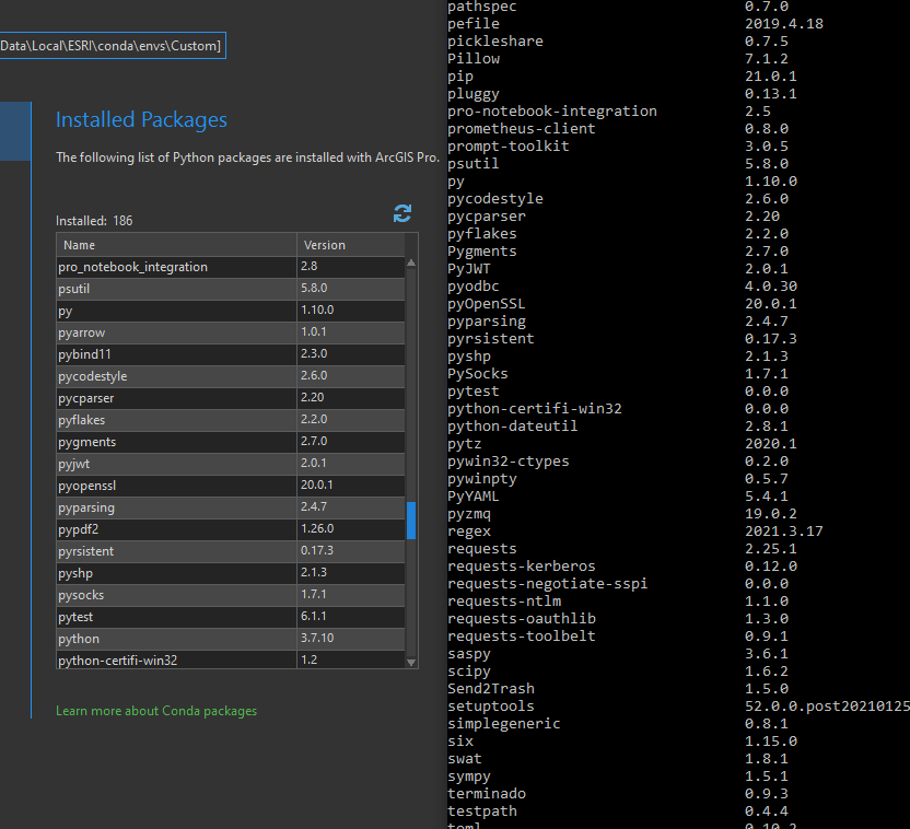

Oh yeah...for sure switching environments, etc.  I had the same thought a couple of times where I was wondering if I was just seeing things.  To further answer your questions...
I made 2 different attempts to get the info you requested and/or get Conda to respond like it normally would.  In both cases, it the command "conda list" were not recognized commands.  Now you and I both know that shouldn't be the case.  So I tested it against a VM that I built from the ground up last night to verify/validate.
So...against the work PC running Windows 10 Enterprise 19041.985, I checked the following:
  • Conda list | "'conda' is not recognized as an internal or external command, operable program or batch file"
  • python.exe -m pip list returns everything you would expect.
  • Visual Studio 2019 recognizes that the python version is a Conda environment.
  • ArcGIS Pro internal work correctly (ie. notebooks, command line, etc.)
Against the home PC running Windows 10 Pro for Workstations 19042.985, I got the same exact results.  Conda was not recognized, but everything else worked as expected.  For the sake of sanity, I attached a snapshot of both the ArcGIS Pro and Python windows side by side.
Oh...last but not least, before I even posted about this, I did uninstall and reinstall the software from the ground up on both machines.  I even cleared out the appdata, etc to make sure there were no remnants and that I was starting on a fresh sheet of music.
