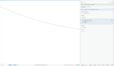

Hi Scott, thanks for your reply. I have created the preset template but i'm having trouble with snapping the polygon onto the line (as seen in the attached video). Am I missing any steps? Any help would be appreciated.

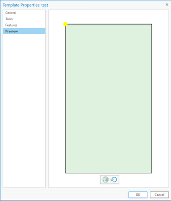

Create a polygon that is horizontal and use that as the selected polygon for the preset template. So the preview should look like this:
You might want to play around with the anchor placement too.
FYI - You can create a horizontally constrained polygon by using the horizontal constraint found on the edit toolbar that appears when using the rectangle tool:

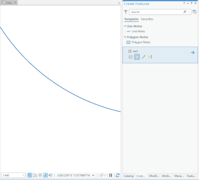

Oh I'm sorry if that wasn't too clear. I was using Inference. More info here: https://pro.arcgis.com/en/pro-app/latest/help/editing/inference-constraints.htm
If you have Inference and Snapping turned on, inference "rays" will appear while sketching and hovering over segments. For the first click, snap to an edge and they will appear. If you snapped to a curve, the rays will appear parallel and perpendicular to the tangent direction of the curve. If you snapped to a line, the rays will be parallel and perpendicular to the segment you snapped to.
  • HINT: hover over any segment while sketching to show the rays for that segment.
  • HINT: turn off your basemap to better see inference rays
  • HINT: required snapping agents need to be set in the map before visiting the preview page of the present template
In this gif, you can see that I'm turning on midpoint snapping and then going into the template properties and snapping the anchor to the midpoint of the top edge of the rectangle. Then I click on the curved line (while snapping to it) and the inference rays appear. I'm now in rotate mode (for the tool) and I can snap to the inference ray that is perpendicular to the tangent of the point I clicked on. This will make the rectangle perpendicular to the curve. Like I said above, there are probably ways to improve this workflow 🙂 but this seemed like it might help in the case you presented.
