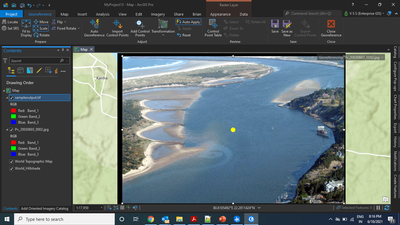

Hi,
For me, it's working fine. I have downloaded your images and I have seen it's falling somewhere in waters as it's just a sample and fake location.
I used the auto georeference option and fit to display option in georeference tab
later I used to move, scale all other options and place it to some in India forest area. And I hit the save button to save the same image,  and also used save as to saved it to other name.
Please refer to the below screenshot and the attached outputs.
