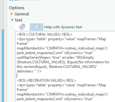

I have created a map series in ArcGIS Pro 2.8.0 where there is a dynamic text box that changes based on the map page and some of the text is formatted to be bold. There is an issue on only one page where the bold tags are showing and the text is not bold (<BOL>Text</BOL>). On all other pages, the text between the tags is bold and works as intended (Text). I created the text in ModelBuilder so the formatting is consistent across all pages and there are no reserved characters or other tags that could be interfering.

Do you recognize any anomaly in the particular Text Value? Could you mention the complete string, as well as the particular Text value?

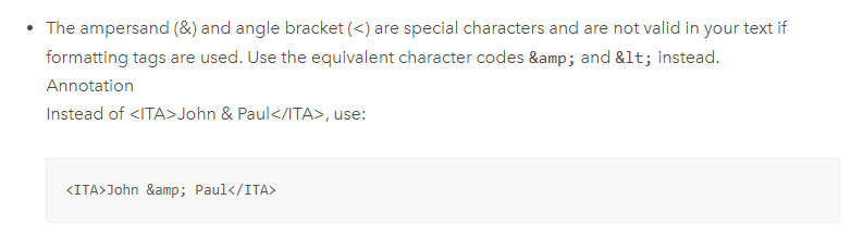

The ArcGIS Pro text formatting tags adhere to XML syntax rules where ampersands and "less than" symbols are special characters. From the help topic "Text formatting tags":
If you have either "&" or "<" within your text you will need to replace the corresponding equivalents "&amp" or "&lt".  For "greater than" (>) use "&gt". For apostrophes use "&apos".
You might find the following, grabbed from the help topic referenced above, helpful in dealing with these special characters.

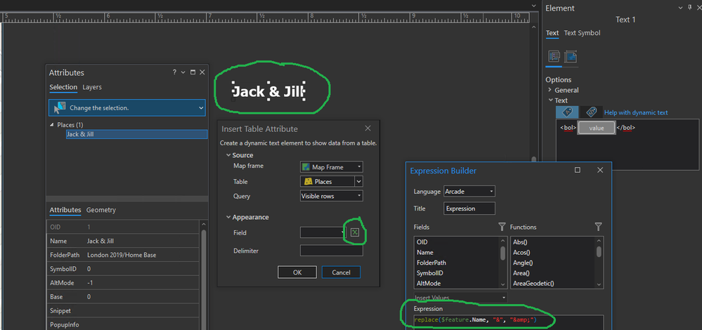

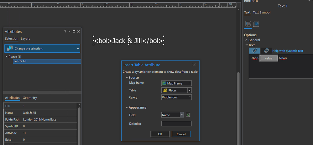

Here is an example. I have a point layer that I'm using to drive a map series. The layer has a filed "Name" and I'm using this field value for the appropriate pages. The name for the first point is "Jack & Jill". I also want to make the text bold so I add formatting tags.
If I don't account for the special characters I will see the tags displayed in my text element.
Using the following Arcade expression - replace($feature.Name, "&", "&amp;") - I adjust for the special character and the dynamic text element displays what I want.
