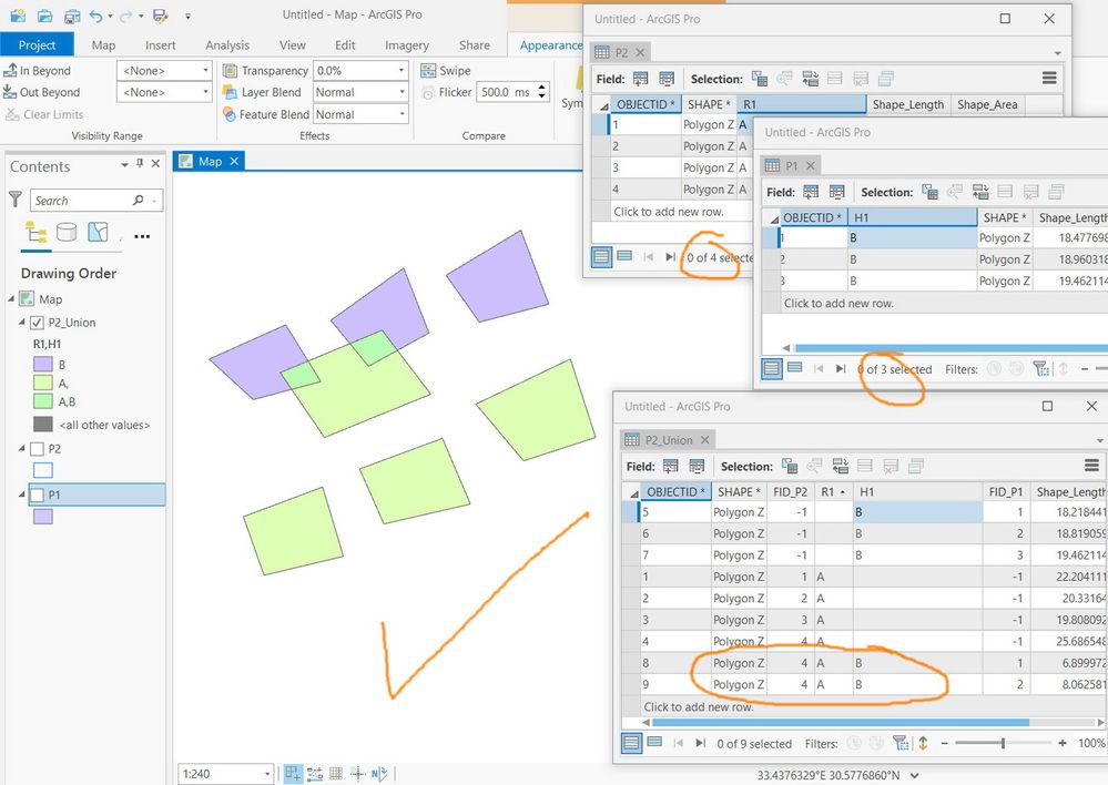

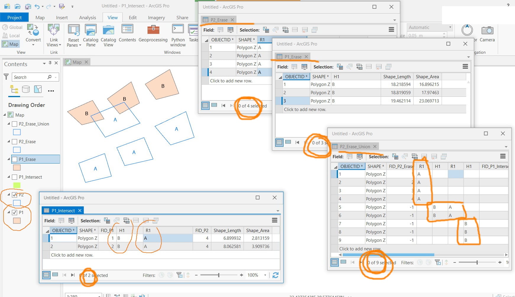

For example, in the screenshot below, the intersection between L1 and L2 is two features. How to keep the non-intersected features so that the outputs ends up with 9 features but not with 2!
I’m aware that I can perform multiple tools to achieve that but wanted to check if there is one single tool that can do the job

Try the union tool

Thank you ThomasThorsen1
Not sure why i thought that the union tool will duplicate the area of interesection! It works fine

How Union works—ArcGIS Pro | Documentation
because
Below is an example of Union with features within a feature class that overlap. In this case, the area of overlap will be duplicated to maintain all the attributes and areas.
