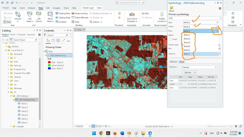

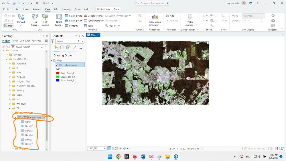

But what the values of RGB represent in the screenshot below?
Jamal Numan
JamalNUMAN
Legendary Contributor

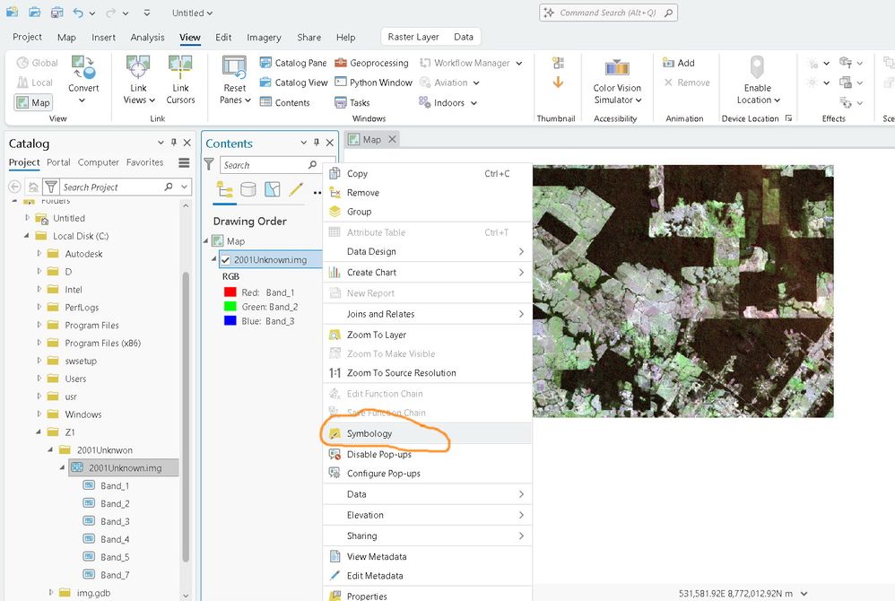

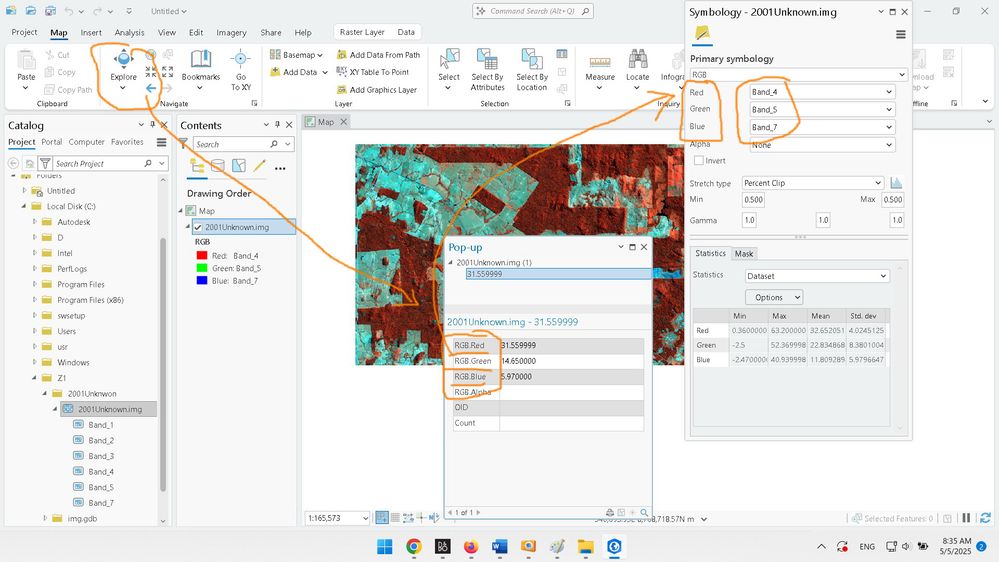

From the symbology, the bands representing the RGB channels are set. For example, in the screenshot below, Red is assigned to Band 4, Green to Band 5, and Blue to Band 7.
Additionally, the datasheet of the imagery should indicate what each band represents
