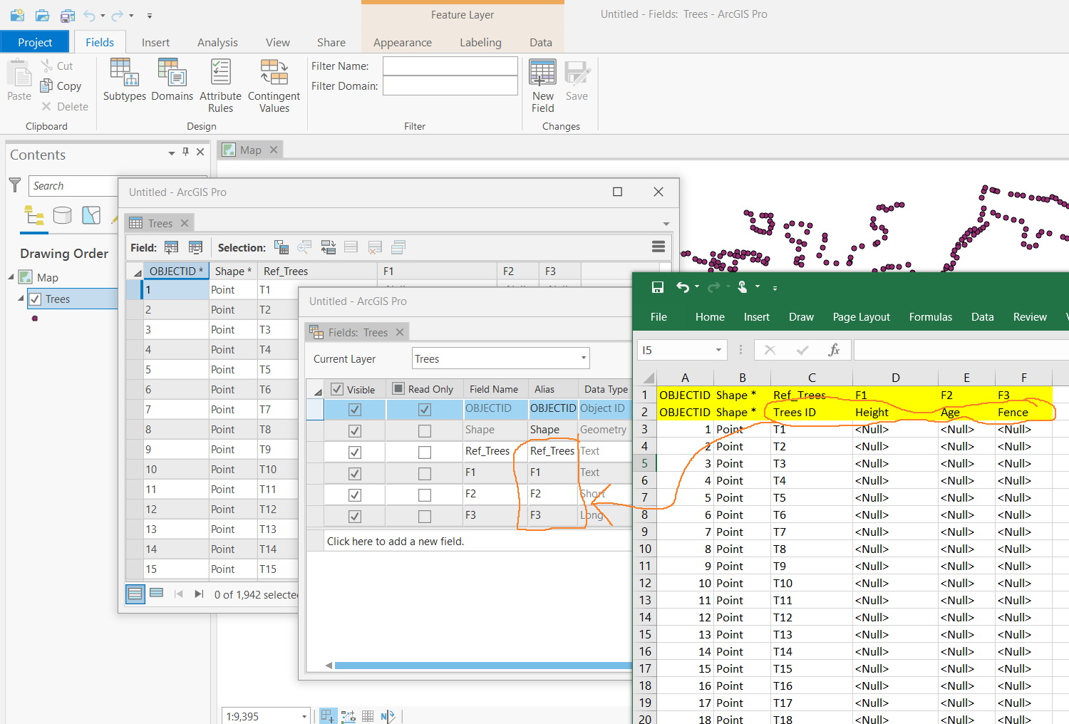

ArcGIS Pro 2.6.2: How to import Alias field to the attribute table when performing join?

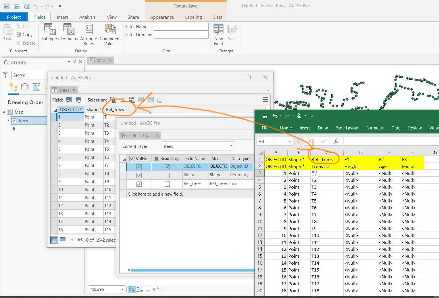

In the screenshot below, the excel table contains a row for field physical name and another row for alias field name. How the alias field can be imported as the attribute table when joined?
There is no option within join

especially for an excel file. Perhaps the alias would be maintained if the table originated in a file gdb with original and alias specified already
Thanks Dan.
Do you mean that we are left with one option: as the data is imported from excel to the attribute table by performing join, the alias fields need to be edited here!
The advantage of working in excel first refers to the fact that the environment is much more decent in addition to the fact that reordering fields is possible in contrast with the case in Pro
Excel is not a substitute for a database management system. you have to work within its limitations.
