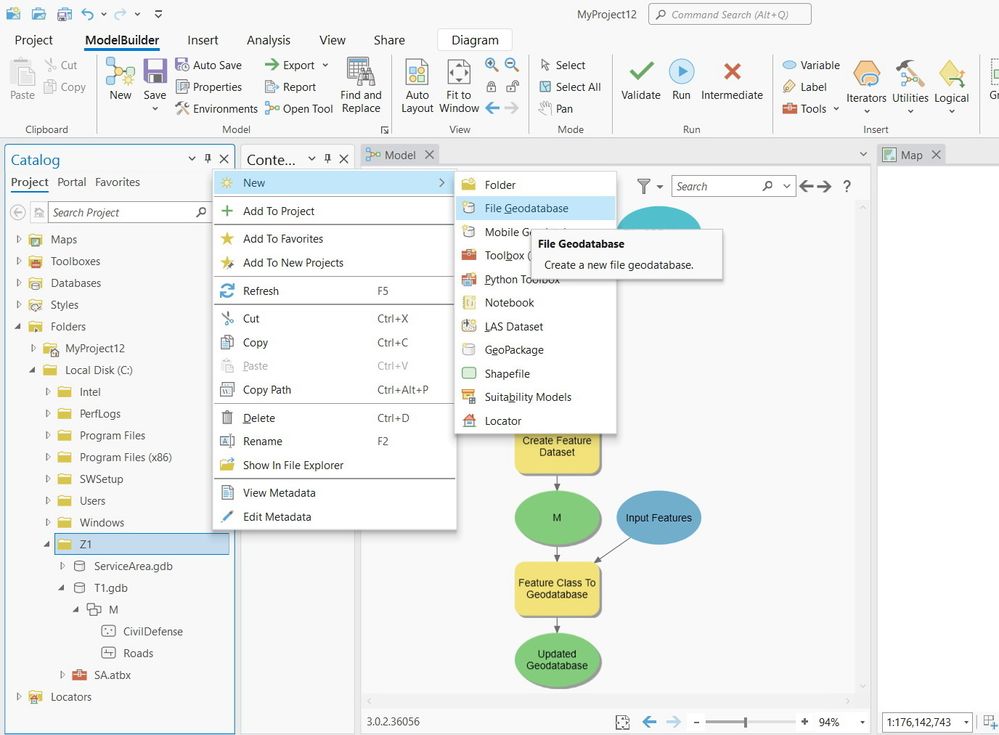

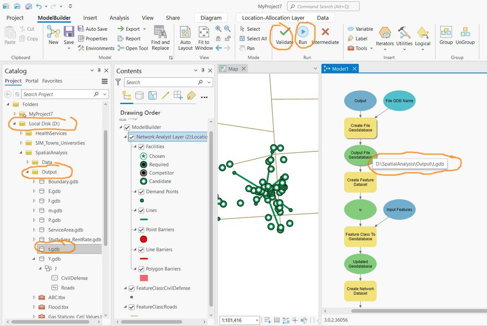

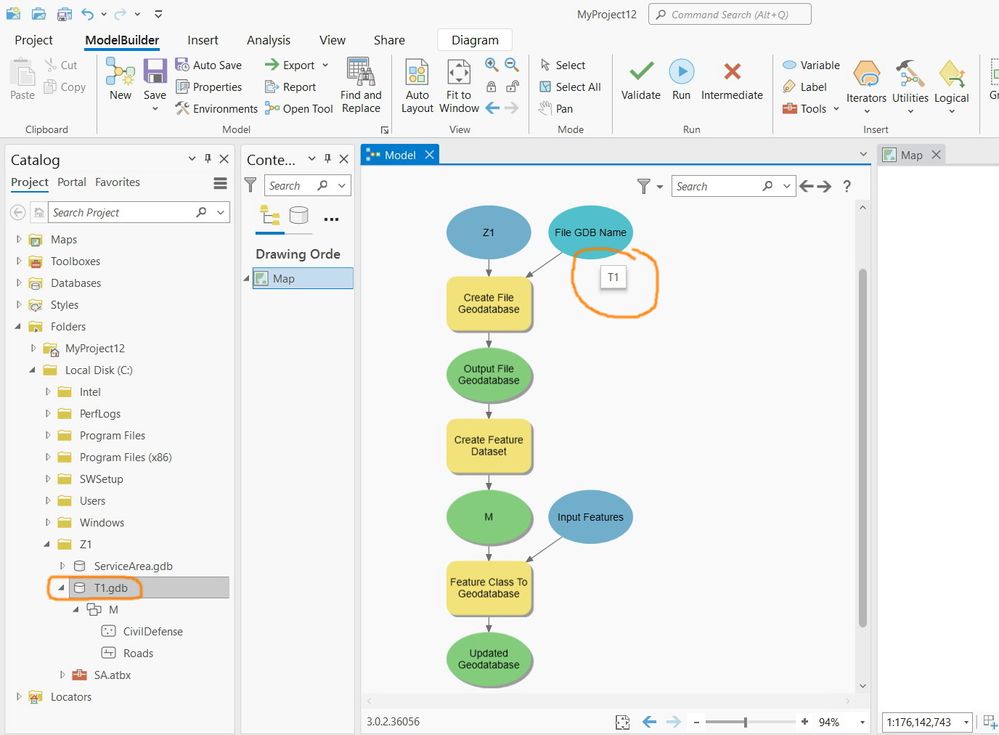

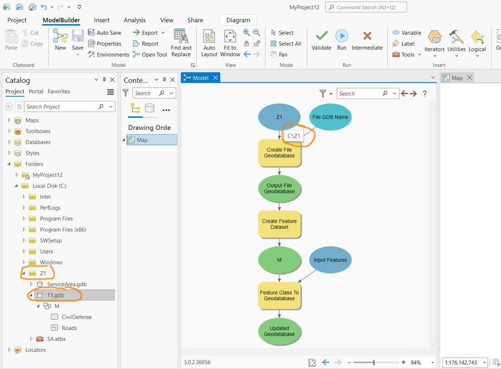

As per the screenshot below, the “create file geodatabase” is the first tool in the model builder. As the model is re-run, the model manages to proceed and doesn’t mention that there is an already created file geodatabase with same name.
What could be the issue here?

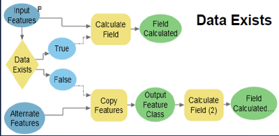

Model Builder warns of an existing fGDB if you open the tool but not when running the Model.
I had success running the If Data Exists Logical tool at the start of the Model to check if the fGDB existed or not and proceeded from there depending on the result (True/False). Here's an example.
