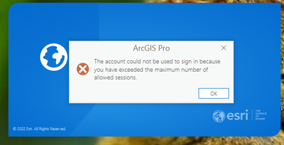

Exceeded the maximum number of allowed sessions
1010
05-08-2023 08:34 AM
JanHurt
Hello, I need a bit of advice. I have been using my arc gis pro school license  when the Arcgis pro closed and when I tried to log in again, this message appeared.
What can I do about this?
AmnoyAm
Assuming you're using a Named User license, have your portal administrator go to Organization>Licenses>View license activity.  Look for the log-in account.  It will show which Pro machine is using the account.  The admin can release the license for one of the existing systems so you can log in.
