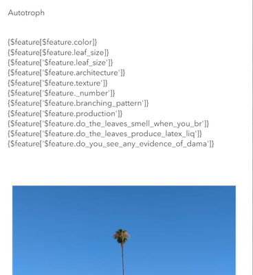

Here's the code.  I added the (), still unsure of where exactly to place $,
function  autotrophs () {
return `
{$feature[$feature.color]}
{$feature['$feature.leaf_size']}
{$feature['$feature.architecture']}
{$feature['$feature.texture']}
{$feature['$feature._number']}
{$feature['$feature.branching_pattern']}
{$feature['$feature.production']}
{$feature['$feature.do_the_leaves_smell_when_you_br']}
{$feature['$feature.do_the_leaves_produce_latex_liq']}
{$feature['$feature.do_you_see_any_evidence_of_dama']}`
function heterotrophs() {
  return `{$feature['$feature.where_is_it_located_does_this_l']}
{$feature['$feature.does_this_location_look_like_it']}
{$feature['$feature.note_the_physical_description_s']}
{$feature['$feature.note_its_behavior_mode_of_locom']}
{$feature['$feature.what_do_you_think_it_might_eat']}`
function abiotic() {
  return `{$feature['$feature.describe_the_air_temperature_wi']}
{$feature['$feature.select_the_choice_that_bests_de']}
{$feature['$feature.how_strong_is_the_wind']}
{$feature['$feature.sun_strength_cloud_cover_']}
{$feature['$feature.do_you_smell_anything']}
{$feature['$feature.what_do_you_hear_']}
{$feature['$feature.what_do_you_hear_other']}`
When($feature.category == 'Autotroph', autotrophs(),
     $feature.category == 'Heterotroph', heterotrophs(),
     $feature.category == 'Abiotic Conditions', abiotic(),
     'Invalid');
Here's the output.
If the $ is placed correctly, will the output display the actual answers?
I really appreciate your support. Thank you. Jenn V
JohannesLindner
MVP Alum
Template literals in Arcade enclose the value you want to insert into the string with `${value}`. Not to be confused with the leading dollar sign on global variables like $feature, $datastore, $map, etc.
  return `${$feature['where_is_it_located_does_this_l']}
${$feature['does_this_location_look_like_it']}
${$feature['note_the_physical_description_s']}
${$feature['note_its_behavior_mode_of_locom']}
${$feature['what_do_you_think_it_might_eat']}`
Yes, it should display the actual field values for the feature you clicked on. If you also want to display the question/field name, you could take my answer or put the questions into the functions of Ken's answer like so:
  return `Where is it located: ${$feature['where_is_it_located_does_this_l']}
Does this location look like it: ${$feature['does_this_location_look_like_it']}
Note the physical description: ${$feature['note_the_physical_description_s']}
Note its behavior mode: ${$feature['note_its_behavior_mode_of_locom']}
What do you think it might eat: ${$feature['what_do_you_think_it_might_eat']}`
Have a great day!
Johannes
JGVadnais1
Thank you for the assistance and clarification of the dollar signs.  Truly helpful!
