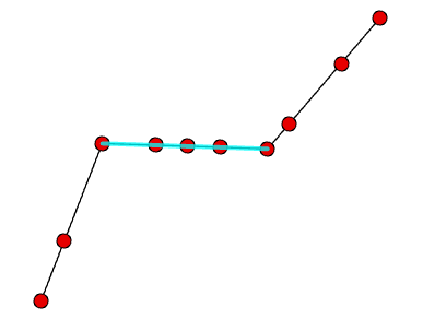

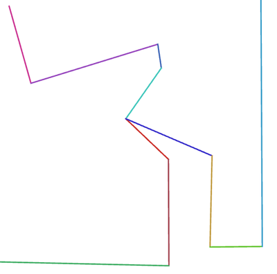

Hello,
I would like to create a line that goes through adjacent points. The condition that I would like to apply to this are the following:
1- if the line that goes through some points change direction, I want a new line to be created
In the picture above, I have shown what I would like to do as an example. I would appreciate the community's help in this matter.

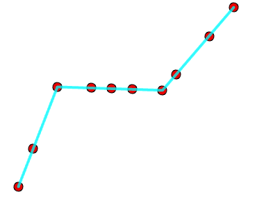

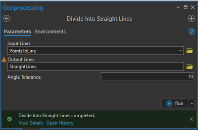

Assuming your points are ordered:
  • Run Points To Line
  • Copy/Paste the script below into your Python Window (without lines 79 and after) and call divide_lines_into_straight_lines
    • alternatively, turn the script into a script tool and run that (also enclosed at end of this post)

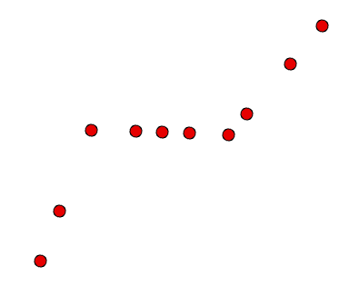

Points:
Points To Line:
Straight Lines:

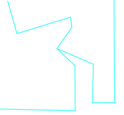

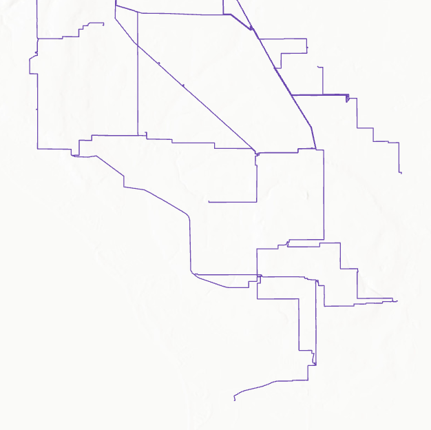

@JohannesLindner I tried using the tool for when a line goes in two/three/more different directions and it did not work. Is there a way to change the code to do the following:
Appreciate your help Johannes.

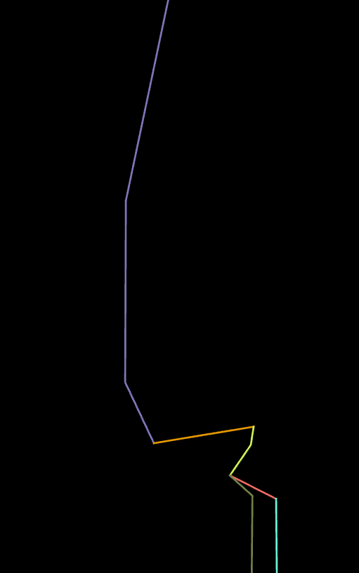

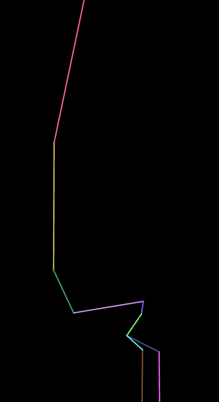

Hmm... The tool has no problem dividing this structure, but it's programmed to work with lines, not points.
If you input this multipart line (it also works for multiple single-part lines):
It returns the correct splits:
The problem then becomes "How to get the points into the correct line shape(s)", which is easy for simple point chains (Points To Line), but might be more complicated here.
Points To Line has a Line Field parameter. If the points have an attribute that differs between the line parts, you can use that.
If you don't have such a field, then you might be stuck doing these corners manually. I could probably rewrite the tool to work with points instead of lines, but I have no idea how I would tackle this case, so it wouldn't do you any good...
Have a great day!

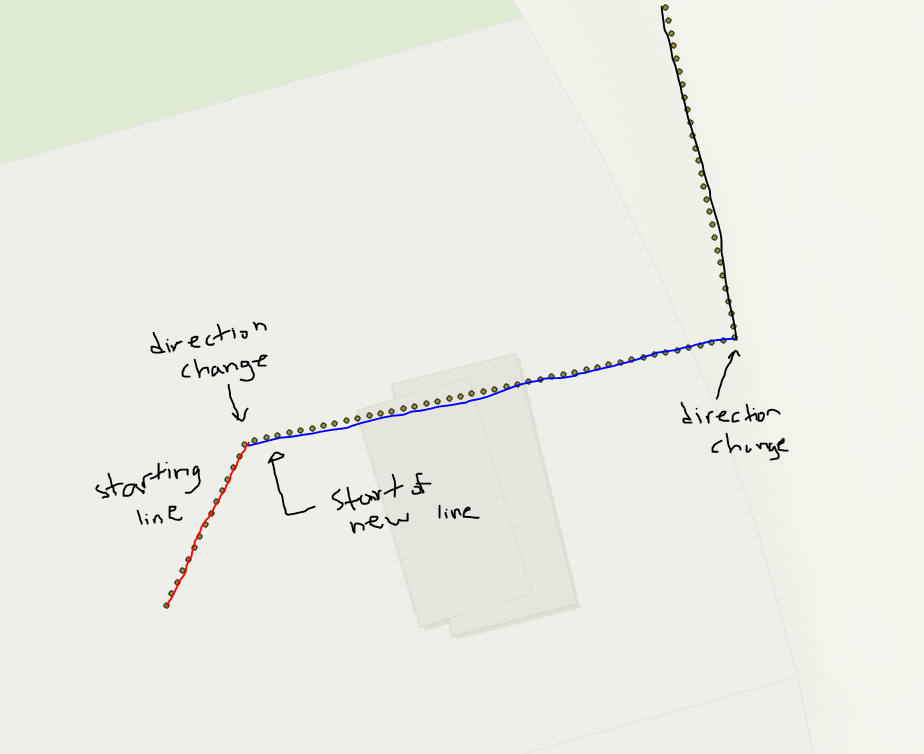

What I noticed is that if all the lines are under 1 line, this tool does indeed work.
But if I have multiple lines that have their own values and GPS points and shape lengths, then it does not. Is there a way to combine the lines with one another? I know relate and join are two tools. I think once we have the bigger line then all of these issues go away.

it seems as though once the problem gets bigger, it is not capable of handling the curves and nicks
This is something I can't test without actual data. Can you send me your point and/or line feature classes here or in a private message?

  • fixed in script and reuploaded the tool
Thanks for the data. After fixing the error, the tool works fine for me. It takes some time (3 to 4 minutes), but that's to be expected, because it does it does expensive geometry computations on 39.000 features...
I took a look at some of the more complex regions, but I couldn't find anywhere where it wasn't "capable of handling the curves and nicks". Can you try again and send me coordinates of places here it doesn't work?
Just to be sure: The Angle Tolerance parameter controls how the "curves and nicks" are handled. If the  difference between angles of two consecutive segments of an input line is bigger than that value (in degrees), then these segments will be in different output lines. If the angle difference is smaller than the tolerance, they will be part of the same output line. So if you want greater differentiation, set the tolerance to a smaller value.
For example, this is the split with an Angle Tolerance of 10°:
When I use 50°, there are less splits:
Have a great day!
