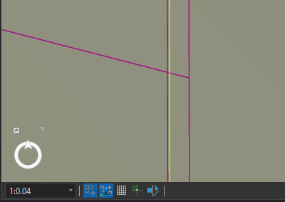

Hi @Scott_Harris , got screenshots documenting what I am seeing happen. We're figuring it is snapping but if we need to open a bug case we will.
Yesterday the parcel lines were drawn in and had properly snapped to the COGO green line. Sometimes we use a COGO reference line to check our work. This is correct from yesterday.
Then today, we find the same polygons have been as we are seeing unsnapped from our alignment green line and no longer within tolerances we would like them to be. Below is what we found.
The shift or unsnap is negligible when considering the scales, but it is causing multiple errors to compound and become a greater issue where the parcels are hanging out into streets or across curbs as they seem to domino down the green line or just an adjacent parcel. This is then being flagged in other systems and agencies that we have to go back to correct if we don't see it because it is not always coming up in our error checks. In each case it is not consistent what is happening to I hesitate to give an overall answer for these just yet as caused by one thing or another, hence trying to see if it's snapping on platforms.
Hope this helps define what we're encountering, thanks again.
Jansen Lyons - Records and GIS Section - Public Works - City of Rio Rancho, NM

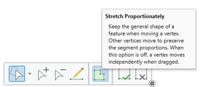

You asked about the Edit Vertices tool in your original post. Edit Vertices should only move the selected vertices if the Stretch Proportionately option is turned off. If it's on, unselected vertices can move. I wonder if someone is unintentionally moving vertices by leaving this option on:

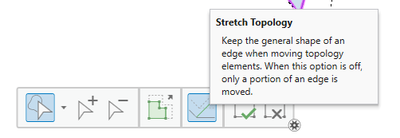

I know you said you don't use a topology, but I'll just include this info as an FYI:
If you use a Map Topology or Geodatabase Topology, and Edit Vertices tool is on the Edges tab, you also get this option, which could also move vertices of connected edges:
