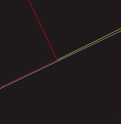

I have a question about snapping.
I am working with line features and notice the vertexes of my lines are not snapping to the edges of lines they are intersecting with even though I have edge snapping turned on. The embedded image shows how they are not snapping. Can someone show me what snapping tool has to be on in the snapping settings?

@SLouq Is it possible that you are zooming in beyond 1:1 for map scale?

How can you zoom in beyond 1:1? I just zoomed in as much as it would let me.
I was always under the impression when snapping is on, you should see no gap between the lines
ETA: You are right. I just looked at it again and I see now how you can go past 1:1 with the zoom.

Yes zooming in beyond 1:1 is allowed, but the distances represented in the gap are most likely negligible and within the XY Tolerance of the data. Feel free to contact Esri Technical Support if you need help verifying.

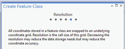

@Scott_Harris and all, I have arrived at a better understanding of XY Resolution that underpins this issue and wanted to share in case anyone else needs to find their way there!
The issue is created when utilizing snaps other than Point, Endpoint, or Vertex. The XY Resolution of your datasets will be leveraged to conform any new/modified points/vertices to their closest spot on the "resolution grid."
https://www.esri.com/arcgis-blog/products/arcgis-pro/analytics/geoprocessing-resolution-tolerance-an...
All line and polygon edges start and end on these conformed points, but virtually all of the coordinates on those lines that can be calculated and snapped to are NOT resolution grid conforming! The initial snap yields the precise coordinate, but the moment you complete the part or sketch, vertices are instantly conformed to the resolution grid. This in turn causes the gap between the new vertices and the existing feature edge that you thought you just snapped to!
Options:
-To eliminate the gap you may add new vertices to those target features at the same snap locations you just used.
This can also help mitigate future potential CAD hatch and boundary command failures caused by "loose topology" (CAD is much higher resolution by default and those tools will flood through the gaps we are currently discussing.)
-There may be a Topology tool that will add vertices wherever another feature is touching (based on XY Tolerance?)
-Python probably has some methods that could do some sort of targeted Densify. I will probably be looking into that, sounds fun!
-XY Resolution Override. Most documents say it voids the warantee, but if you are currently within a step or two of resolution of this not being a further issue I would seriously consider it.

Considering you are only seeing the offset when snapping to an edge, it actually might be expected. Why? If you were to draw a 2-point line where the endpoints are snapped to the coordinate grid (defined by the XY resolution), you can't really guarantee that any given point along that line will intersect the grid exactly.
Regarding your test: If you plug those 2 sets of coordinates into a distance formula, you get something like 0.00019 units. Assuming those are meters, that is less than the default XY tolerance of 0.001 m.
I'd say that's an acceptable distance, however, I do agree that it causes a bit of anxiety to see that on display in your map. Something interesting about that: only starting in version 2.5, did Pro start allowing you to zoom in beyond 1:1 - so these types of things wouldn't ever be noticed prior to that. As far as I know, ArcMap didn't allow zooming in beyond 1:1. I can't account for every version of ArcMap, but the last version seems to not allow it.
One thing you can do is create a topology with the default cluster tolerance (0.001 m) with no rules and validate it. Once you validate everything within 0.001 m will snap together. This will change the data by adding vertices to edges where they intersect to allow for clustering to occur.
