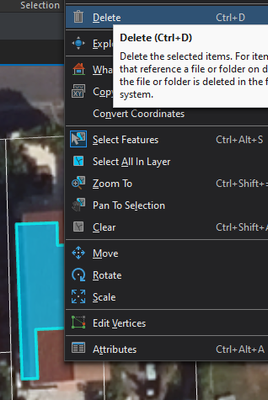

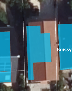

Hello,
under ArcGIS Pro 3.3.0 , after deleting a polygon feature, it does not disappear and stay displayed on the screen. I have to close and open ArcGIS Pro to refresh the screen...
