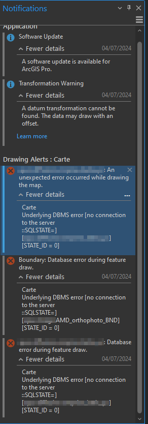

I realized that there were errors while performing my update operations :

Now it's ok :
I had to recreate my ArcGIS Pro Project ( it was created under a previous version of ArcgGIS Pro) and it's seems to work correctly.
