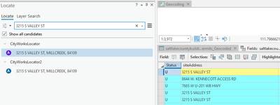

Notice  the address 3215 S Valley St went unmatched yet I can use the find tool with the locator I used (CityWorks2) and it hits on an address point...I have the locators set to Match With No Zones = YES....

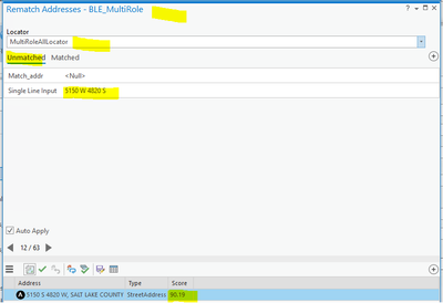

@ShanaBritt ;  I can replicate the unmatched while geocoding but shows up during rematching with just a multirole locator only, not a composite:

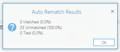

@JoeBorgione When on the Unmatched tab in the Rematch Addresses pane, does clicking the Auto Rematch button match the unmatched addresses?
JoeBorgione
MVP Emeritus

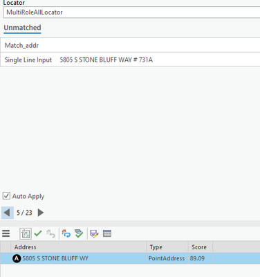

@ShanaBritt   It doesn't appear to have any effect on them:

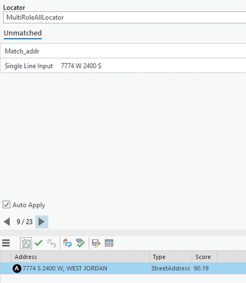

Stepping through them I see a few addresses that have unit numbers that are listed as unmatched but resolve:
and others that are unmatched, but show up with a good score and IMHO should have matched to begin with:
I have the locator properties to match without zones and a min match score of 85.
