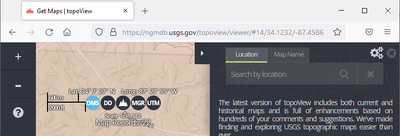

I can't seem to get that work around to work.  Here's the URL that I have built up but it still goes to ArcGIS Pro's little browser which is not what I want.
<a href="https://ngmdb.usgs.gov/topoview/viewer/#14/34.123/-87.456"><img width="20" height="20" border="0" align="center" src=""/>Topoview</a>
NickHarvey
@GaryB  -Hey Gary - Here's what a field-based version looks like in my installation of Pro 2.8.1 (below) - Which version are you using?
-Nick
GaryB
Thanks Nick, unfortunately I'm stuck with 2.7.3 for the moment.
