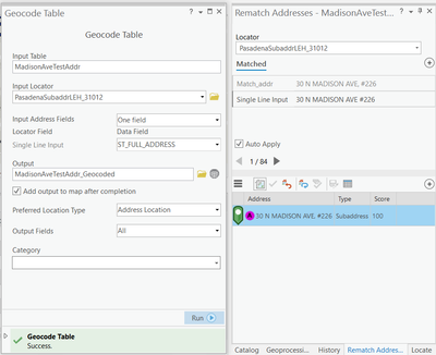

@JoeBorgione What I'm suggesting is that you build a locator w/o any zones (city, jurisdiction, zip), then geocode the table of addresses using Single Field for the input address fields. This is the recommended workflow when your input addresses don't have zones. There have been improvements to the locators built with the Create Locator tool since you could first build them in Pro 2.3. Below are my results where all 84 were matched.
If your input addresses have zones or an address could fall inside of multiple zones, it is best to build the locator with zones and batch geocode the address with zones or input the partial address and select the suggestion.

@JoeBorgione Any luck with a locator built without city, state, or zip and geocoding with a single field?

@ShanaBritt   ...geocode the table of addresses using Single Field for the input address fields.  Ah ha.  I see what you mean now.  Single field, and not parsed address fields.  I can do that.
...the recommended workflow when your input addresses don't have zones.  I didn't know that; is that documented somewhere?

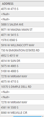

I misunderstood what you are suggesting here, thinking that I should create a locator with a single field of reference.  When ever I geocode a table, that table has one field: ADDRESS and all the values are in the form of:
1234 S MAIN ST
4576 S MAIN ST # 101
I may have Null values here and there, but they typically are all filled correctly:

The data I am trying to geocode has tons of records where the ADDRESS field is Null.  If I first geocode the entire table I get something like 3500 unmatched records.  I then select where ADDRESS is not Null and that leaves me with only 270 to rematch.  That's manageable, but not so much if I'm constantly getting bounced back to #1.
