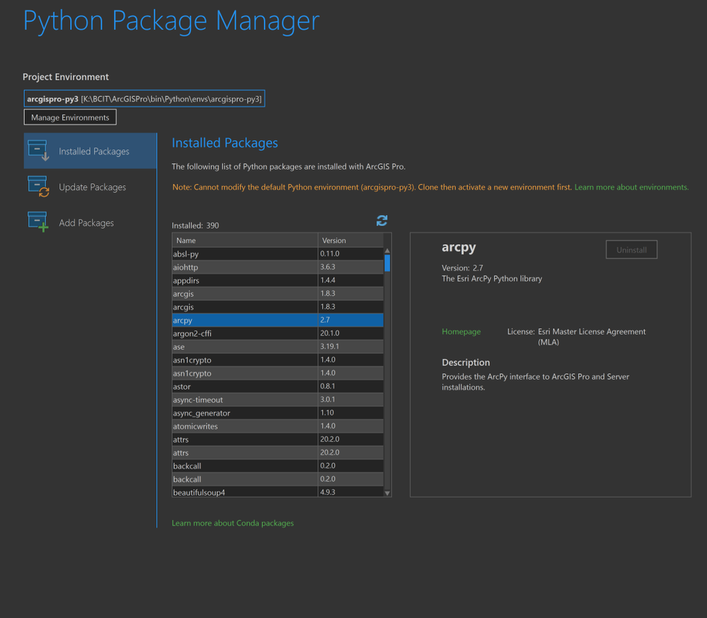

Anyway, this is what my environment looks like.  This should be all from the Deep Learning 2.7 installer (https://github.com/Esri/deep-learning-frameworks).
EDIT:  After looking at it, I'm not even sure if the DL package stuff is even installed.  Weird, because it was still doing Deep Learning stuff...  unless that added that into ArcGIS v2.7.
EDIT: I re-ran the installer but it is all the same.  Still has keras and tensorflow packages so must be the deep learning one.  I'm so confused because apparently the ArcGIS notebook is supposed to be an inhouse feature, not even connected to Jupyter (except in style and format).

K drive... local drive?
in any event, you seem to have a lot of duplicates listed in your package list.
This is the latest for arcgis.  I wouldn't go to 1.8.5 yet since it is in pre-release
Files :: Anaconda.org
I can't compare your environment since I am on Pro 2.8 beta 1, but the duplicates in your package list certainly isn't good.

Yes, k drive is local.  I cloned the environment and it ended up with 284 installed packages, appears to have left out duplicates.
...and now suddenly notebook works in ArcGIS wow   😐
Must have been an issue with duplicate packages in the default environment.  Pretty sure that happened when I did some PC upgrades and had to re-install Windows.  Also ended up re-installing ArcGIS on a secondary drive I had it on, and it didn't uninstall properly.  It all makes sense now.

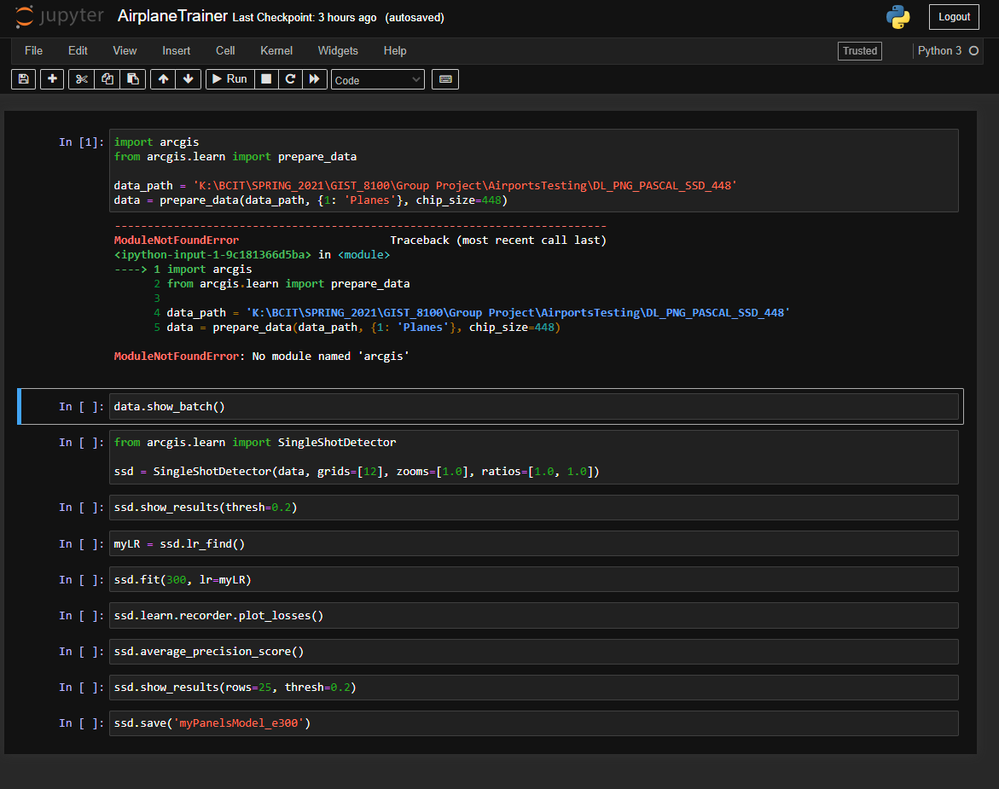

Now I am curious about how arcpy works when using it in a Jupyter notebook in Chrome (I will be progressing towards this method later on with deep learning, for instance with Google Colabs).
Attached is an image of my trying to run code for training the model, and it doesn't want to recognize arcgis (with or with the first line "import arcgis").  Do I need to install arcgis packages into anaconda now?
DanPatterson
MVP Esteemed Contributor
if arcgis isn't in the environment you are working in, it needs to be installed there as well.
