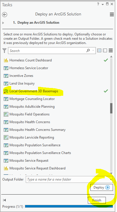

I'd like to launch the 'Local Government 3D Basemaps' solution/tasks to a new ArcGIS Pro project.  How is this accomplished?
I have the ArcGIS Solutions add in installed; under the Share Tab I select ArcGIS Solutions and I then given the 'Deploy a Solution' window.  There, I select Local Government 3D Basemaps'.  I can click deploy or finish and nothing really happens.  I have had this working with the canned ESRI package, but there seems to be a a hiccup or two associated with that so I'd like to continue working in my own project.

Your screenshot shows an Output Folder that you can navigate to on your network whether it be local or on the network.  If you don't modify this location, Pro just uses the default location on the c-drive that you pointed out earlier.

I pathed it to two different locations: first time to where it was originally, and then to the project directory set up when I created the new project.  Still get nothing.  Upon clicking deploy, it bumps and grinds like it's trying to do something, but when the dust settles, the only task that shows up is the Deploy an ArcGIS Solution.

Did you already deploy the Homeless Count Dashboard solution as I see it's checked?  If so, can you try to deploy it again to a different location?  It that also fails, maybe something has changed on your computer/network from when it was successfully deployed in the past.

From the note in the documentation for the Local Government 3D Basemaps solution: ArcGIS Solutions will be deployed in the ArcGIS Pro active portal, and not in your active ArcGIS Pro project.
Deploy solution - Local Government 3D Basemaps | ArcGIS Solutions for Local Government
So in this case, the Local Government 3D Basemaps Project Package should show up in your content in ArcGIS Online or Portal.
