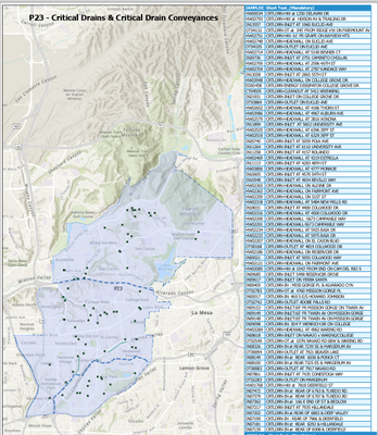

How is it not possible to easily split a Table Frame across multiple maps, similar to a map series?
To fit the table I needed to display, I had to use a size 8 font. I wish there was a way to split the table after 20 elements onto another map layout, similar to a map series.
AubriOtis
@RyanBohan have you tried a report? From your picture it looks like that might work for this layout while this idea is still being considered.
