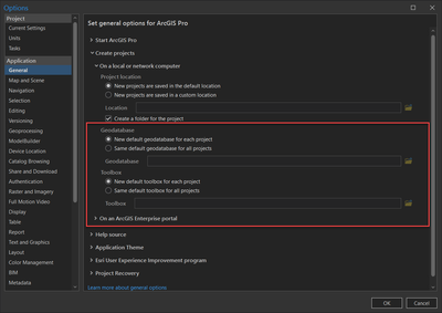

SSWoodward
See honestly I think the creation of a bunch of ATBXs is a lot more annoying than geodatabases.
Maybe a setting in Options that would create like one central ATBX, etc. if toggled?
@AlfredBaldenweck This already exists in the backstage.
Options > General > Create Project

One side point, in case some people are not aware of this option when creating new projects: instead of letting ArcGIS Pro create a default geodatabase and toolbox, you can designate a pre-existing geodatabase and toolbox for all new projects that you create from here on, by using the settings in the Options dialog (General tab, Create projects section). Note that you can change these settings any time and as often as needed.
