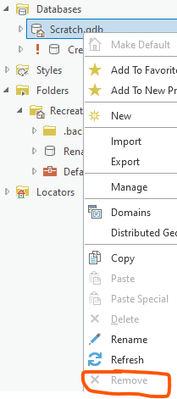

Here is what I see when I tested:
If the geodatabase that I renamed in Windows file explorer was the project's default geodatabase, when I re-open the Pro project, yes, Pro creates a new geodatabase.  A project must have a default geodatabase - in the UI, notice that it is not possible to remove the default geodatabase.  It is necessary to first set a different default, and then the first one can be removed.
So I imagine this behavior, if we're talking about the project's default gdb, is designed to ensure that the project always has a default.  I think that answers, "if some one has accidentally moved or deleted the geodatabase - what is the point of recreating an empty one?"
During my testing, I do not see the behavior you're describing if the .gdb folders that I'm renaming in Windows file explorer are not a project's default.  This is where additional details would be necessary to fully understand the idea.
For the question "Can we have this behavior stopped - or perhaps there is a way of stopping it already?" I guess I need to ask how you have your Create projects settings set up.  Is a new default gdb created for each of your projects?  Or are you pointing to a single gdb as the default for all your projects?
From the information that we have so far, to avoid Pro creating a new empty default gdb, I'd say to make sure that the gdbs you're renaming in file explorer aren't set as a project's default.  Then I don't think you would see Pro creating a new gdb so that it has the requisite default...
Please let us know if what I've explained above lines up with what you're seeing, or if you are seeing different behavior and we can go from there.
Thank you!
