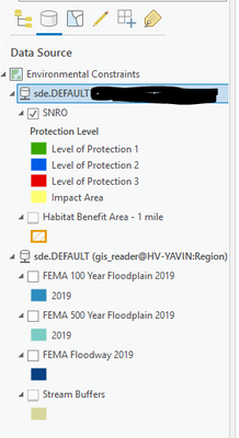

ArcGIS Pro 2.9.5; Oracle 18c 10.7.1 EGDB:
Contents Pane > List By Data Source tab:
It would be great if we could right-click the data source grouping to change the source of all layers in the grouping, such as changing the .SDE connection. All within a single action.
