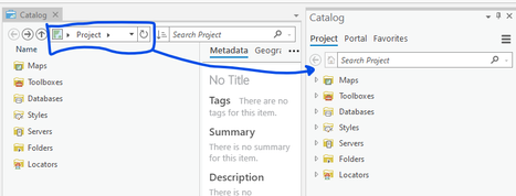

It would be nice to have an 'address bar' on the Catalog Pane like the Catalog View. An address bar would allow us to copy and paste paths to resources (folders, geodatabase feature classes, toolboxes, etc). The pane is handy because it's dockable to the side of maps and tables, whereas the view is not. The view also consumes too much valuable screen 'real estate'. Adding an address bar under the 'Search Project' bar on the Catalog Pane would give us the best of both worlds.

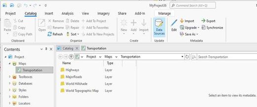

For items such as layers in a map, there is still work to do to allow you copy easily their data source path, but this need is captured in a separate idea (https://community.esri.com/t5/arcgis-pro-ideas/copy-the-text-from-quot-source-quot-layer/idi-p/11155...).  So we are changing the status of this idea as Implemented. In the meantime you could use this workaround to get the path for the data source of a layer: in a catalog view, browse into the map of interest; click Data Source on the ribbon:

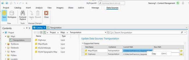

In the Update Data Sources panel, in the current Path column, select the path string, and then either right click > Copy in the context menu, or type Ctrl+C to copy the path:
