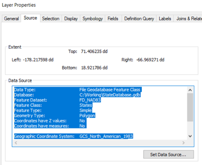

In ArcMap, I very often highlight and copy the entire text from "Source" in the Layer Properties and paste it to Notepad. This helps me access the feature class in the catalog, set or repair the data source or check for lock files in a gdb.
In ArcGIS Pro, I have to copy the gdb, feature dataset and feature class separately, which takes time and effort.

Thank you for submitting this idea @IlkaIllers1 !  The title makes it sound like it is important to copy all of the text from the Data Source window like you do in ArcMap:
But this line "In ArcGIS Pro, I have to copy the gdb, feature dataset and feature class separately, which takes time and effort" makes it sound like the real need is an efficient "copy path"; i.e. for a map layer, provide an efficient way to copy the path of its data source.
Can you clarify whether the path is the primary need, or whether copying all of the text is the need?

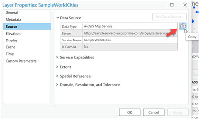

TanuHoque
Status changed to: Implemented
This Idea has been implemented in ArcGIS Pro 3.2. Please see the What's New documentation for more new features in Pro 3.2.
The Your Ideas in ArcGIS Pro 3.2 blog and video have been posted to the Esri Community blog. You can take a look at these to see your idea and all others that were implemented in this release of ArcGIS Pro.
