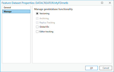

I have my Feature Dataset, Versioned + METB, containing a Feature Class also Versioned + METB. Then I Paste in another Feature Class which is not Versioned and both those Feature Classes stay as they were, resulting in an odd mix inside the Feature Dataset. The Feature Dataset then shows its Versioning status like this, neither ticked nor unticked, reflecting that mix inside it.
If I then tick the Feature Dataset's Versioning + METB box, the non Versioned Feature Class is then made Versioned + METB to match the Feature Dataset and the other Feature Class.
Or if I then untick the Feature Dataset's Versioning box, then the Versioned + METB Feature Class is unversioned to match the Feature Dataset and other Feature Class.
Does this way of working address the basis of your Idea ?

@ChrisUnderwood Thanks Chris. I don't have that "Manage geodatabase functionality" tab in the properties of the FD in my version of ArcGIS Pro (2.6.8). That functionality must have been added in a later version of Pro.
I also didn't realize that it's possible to have FCs with different kinds of versioning in a feature dataset. Not sure if that's relevant here or not.

In summary:  Dragging an unversioned feature class into a versioned feature dataset does not un-version the feature dataset.  The newly added class is not automatically versioned, but must either have versioning enabled through it's properties menu, or by navigating to the manage pane of the feature dataset's properties.
