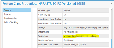

I have a feature dataset that has FCs with different kinds of versioning:
  • BC_FC_Versioned_METB
    Versioned (with the option to move edits to base)
  • BC_FC_Versioned_Not_METB
    Versioned (I didn't use the option to move edits to base)
