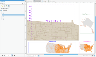

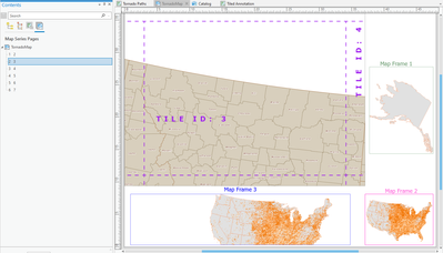

I set up a quick layout based on your explanation.  This layout has multiple map frames, and could have any number of other layout elements.  The main map frame is the one showing the tiles I'm working with.  I was able to set up a map series on that map, using the index polygon layer used in the Tiled Labels to Annotation tool.
Here is tile ID 3:
And then I can use the map series controls to move to the next tile:
or jump to any tile.
Is this getting closer to what you're trying to do?
