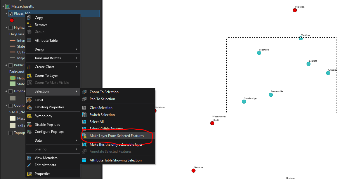

In Arc GIS pro, when exporting layer to KML it exports all the objects to KML despite we only select few object.
Can this be fixed so that it allows user to export only selected objects if that is what they intend?
8 Comments
KoryKramer
I just did a quick little test and it looks like you can use Make Layer From Selected Features
and then feed that into the Layer to KML tool.  That should do what you need.
