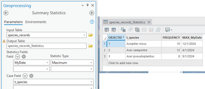

2. Run Summary Statistics to get the "max" date per species:

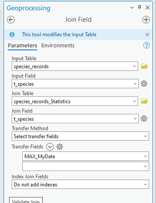

3. Run Join Field to transfer MAX_MyDate back to the input table via the common field t_species:
