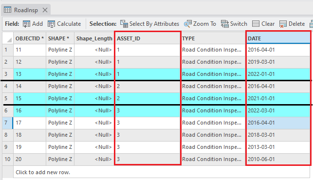

Idea: Need an OOTB geoprocessing tool that can be used to select the greatest 1 per group in a FGDB table.
For example, for a given ASSET_ID, select the road inspection that has the latest date.
I don’t want to create a new FC or create a database view. I want to make a selection in the attribute table of an existing FGDB table.

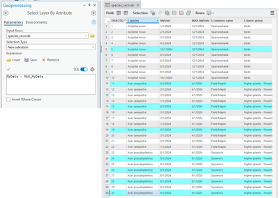

Thank you for thinking of me/us.  I did the following using existing tools:
1. I put your data into a gdb, added a new field MyDate (date type), and converted the information in t_date (a text field) into real date values into MyDate.
2. Run Summary Statistics to get the "max" date per species:
3. Run Join Field to transfer MAX_MyDate back to the input table via the common field t_species:
4. Run Select Layer By Attribute to get the expected selection:
You can put the above into a model or a script.  Hope this gives you a lead.  Of course you can script without running the existing tools.  I won't have time to help you get that done, sorry.
