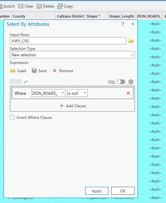

KoryKramer
@GISJess You could use Select by Attributes to select records where the values in a field are null.
With the selection in place, then Calculate Field to populate those values all at once instead of one by one.

KoryKramer
@GISJess
"It would be nice to have the find/replace be able to also find the blanks to make the process faster."
Sneak preview of ArcGIS Pro 3.1, scheduled for February 2023:
