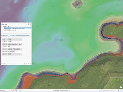

I have successfully 'drag-and-dropped' the ENC cell (US4AK3OV at U.S. Office of Coast Survey (noaa.gov)) for the portion of Southern Alaska Peninsula that I surveyed back in 2005-6, seen here in this screen grab.
Note that I have also brought in the bathymetry from that survey, and have made the chart somewhat transparent. The SEAARE name "Cushing Bay" in the west-facing bight on the north end of Mitrofania Island was selected (clicked) to get the following popup:
So if this is not working for you, we may need to see what ENC file you are using and determine if it has some characteristic that is not recognized by the software.

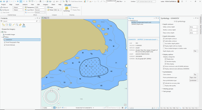

I am using Pro 3.2.0 Advanced without the Maritime extension. Thus the drag-and-drop should work for you as well as it does for me, and the "ENC Layer" tab will look like this, with the S-52 Symbology and layers per the right-hand side after I clicked Symbology:
I hope this is helpful to you.

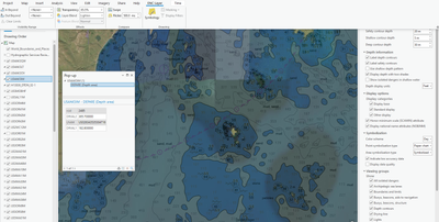

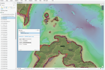

I did tested on our data from different regions and based on the problem with one of the ENS mentioned in these string of comments (here is a snapshot of the functionality).
Like I was saying while back you can create GDB with ENC based template and load your ENC data into GDB (Import S-57 cells to a geodatabase—ArcGIS Pro | Documentation) and you will have total control of the data like in ArcGIS but without symbology like you get used to, but when you load both .000 file and the nealy created GDB with ENC, you will be able to do both (view with symbology and have .gdb to query).

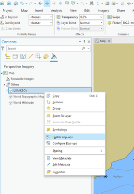

Now I am also thinking that you might need also in Pro make sure that you activated your pop-ups for ENC's.
