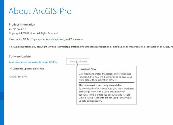

I wanted to provide an update here for others with the same issue as I recently encountered this problem. As other commenters described, ArcGIS Pro cannot update if your licensing source is Arcgis Enterprise Portal. The suggested workaround is to change to an organizational Arcgis Online account for software updates OR have your Enterprise administrator send out update installers. The first option is not possible as all Portal users do not have AGOL accounts and the second option is cumbersome with the frequent ArcGIS Pro updates.
I just spoke with technical support today regarding this problem. This issue has a bug number (BUG-000114544) and a fix is not currently planned, with the explanation being it is a "user error".
Here is screenshot of what I see when trying to download the update:
Download Now not working with enterprise portal licensingDownload Now not working with enterprise portal licensing
I hope that ESRI reconsiders and plans to fix this bug.

Thanks @NickWeil for the post. I read your post after spending a couple of hours trying to figure this out. I hope Esri fixes this up. I think the only option left is to manually download the new version from the MyEsri account and install it.

This setup is hard to understand as end user. We obviously have the product installed and we surely have a license, either by AGOL or floating licensemanager.. What is the reason for ESRI not to let users upgrade and install patches? A classic question of income protection vs good customer experience.. and in our situation, we are valid customers with Enterprise portals and floating licenses, but stuck with **bleep** customer experience.
