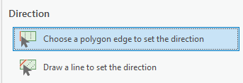

Modify the existing "Subdivide Polygon" geoprocessing tool OR update the Modify Features "Divide" tool so that a user can divide by "Proportional Area" for more than one polygon at a time. There is a selection pane (see below), but it's useless as you can only select one feature at a time for the "Proportional Area" option. Please enable multiple feature selection in the "Divide" tool OR add "Proportional Area" to the "Subdivide Polygon" tool so it can be run in batch.

Currently, when you use the Divide tool on a polygon, you have to choose either a polygon edge or draw a line to set the direction that the polygon will be divided:
Would it be useful to you if ALL of the polygons that you selected were divided along the same direction line?
Or would you expect to be able to set a direction line for each polygon individually?
Or would you expect the software to figure it out somehow? If so, using what logic?
Thanks for any input.
