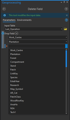

So I'm in the process of creating a model in Model Builder and are using the Delete Fields tool. Currently, I need to select each field I want to delete one at a time by selecting from a drop down list and scrolling through all the available fields (and non-available fields - would be good if these were hidden too).
It would be much more efficient if instead of having to select fields from a drop down list, one-by-one, all the fields were listed with blank check boxes, so I could rapidly check the ones I want to delete and hit OK (unavailable/system fields greyed out).

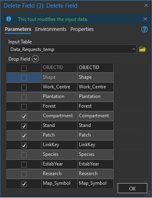

It exists already in Pro 2.8.
Are you saying that dropdown  beside the Drop Field doesn't keep the checkbox open when you make a selection?

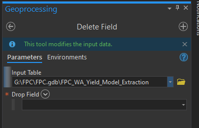

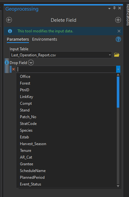

I used a geodatabase table in my example... I noticed that yours is a *.csv.  See if the behaviour exists with it converted to a gdb table
LindsayRaabe_FPCWA
Yep - still coming up with a table in a GDB. And that is straight through Pro (not in Model Builder).

Sounds like a "bug" or install issue, since it certainly works for my data and setup

It does give me al ist of fields, but when I select one, another blank line appears and I have to drop the list down again and pick the next field, and then again and again and again... No check boxes appear as in your picture (which is what I want).

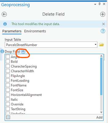

@LindsayRaabe_FPCWA I merged your recent idea with this existing idea about the same topic - the first comment on this one was a question about using the Add Many functionality next to Drop Field as Dan has indicated on your new thread.
That gives you a checkbox experience:
