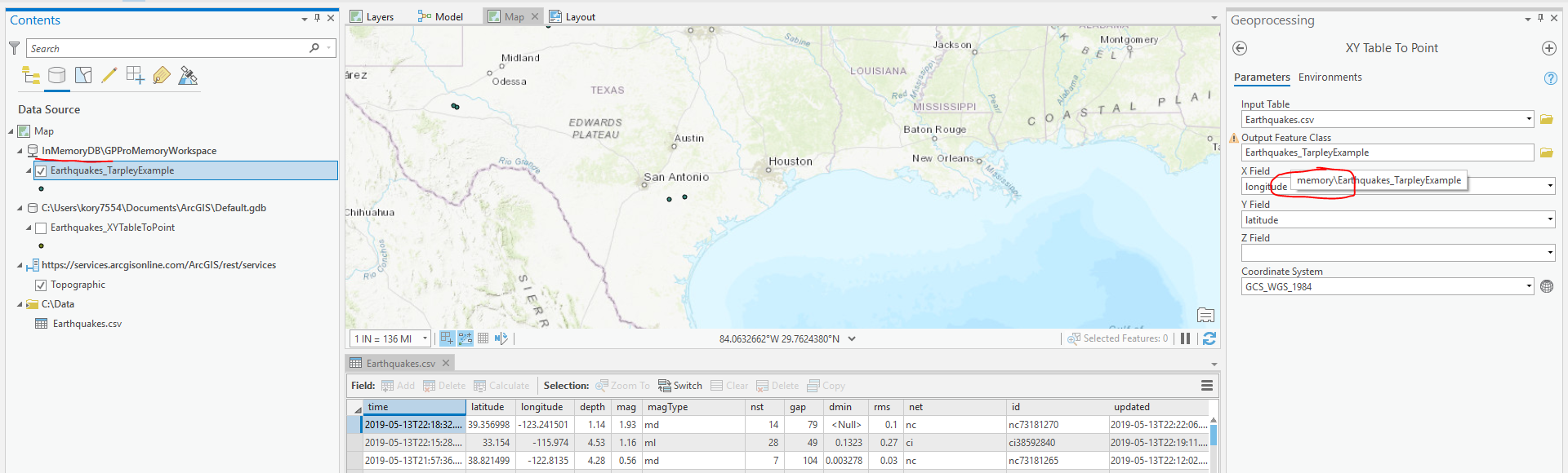

I didn't see any screenshot.  I went to https://earthquake.usgs.gov/earthquakes/feed/v1.0/csv.php and grabbed some earthquake data for the last 7 days.
I create a feature class from it using XY Table to Point and get this:
Now, if I were maintaining a feature class of earthquakes that I wanted to add to, I could just create those points in memory, select only those that I want to add to my feature class, and Append to my feature class.  That way you persist the points that you want in your long-term feature class (say for all of Texas) but aren't building up redundant data from the USGS Excel sheets.
Would something like that work?  Wouldn't require any manual editing at all, and if it works, you could script it or build a model...
https://pro.arcgis.com/en/pro-app/help/analysis/geoprocessing/basics/the-in-memory-workspace.htm
https://pro.arcgis.com/en/pro-app/tool-reference/data-management/append.htm
