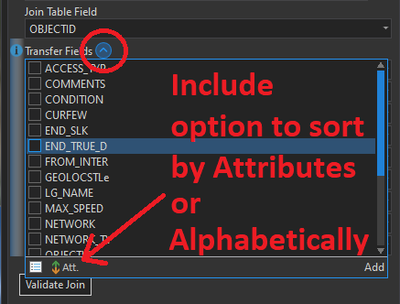

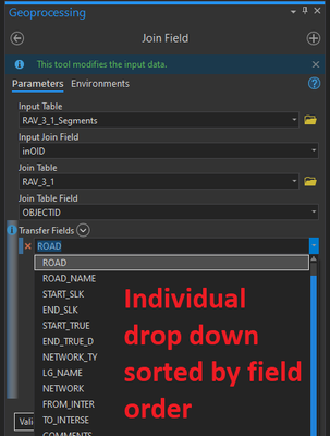

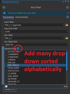

It would be good if the "Add many" option which appears in many geoprocessing tools when dealing with fields had the option to change how the fields are sorted. At present using a tool (i.e. the Join Field tool) and you go to Transfer Fields section, you can either select individual fields from the provided drop down window (which are sorted as per the attribute table), or you can select "Add many" and check the boxes to add multiple fields, or all fields in a quick, easy manner. In my current use case, I'd like to preserve the ordering of the fields but when I use the Add many option, the fields are sorted alphabetically. I understand this can make it easier to find fields in long lists, but it would be good to choose what order the selected fields appear.

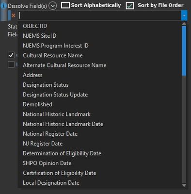

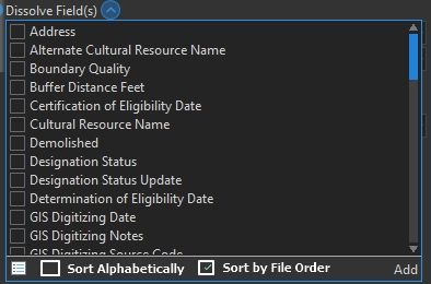

For field dropdown lists, we added options on which fields were available and how they are displayed.
For multivalue controls we added the same options if it is a field type, and also added a search control to the AddManyPopup for those with LOTS of fields this will hopefully save you time.
Filtered to show field aliases:
Filtered to show field names:
