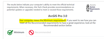

For what it's worth, it looks like my computer meets the minimum requirements:
AyanPalit
@Bud That's a start but you should really target the Recommended specs and tweak some of the parameters as noted in Troubleshooting Performance Issues in ArcGIS Pro
